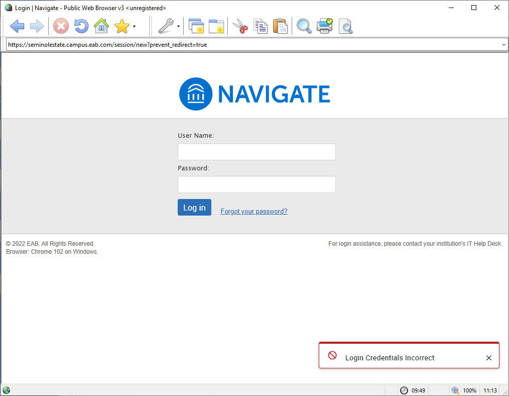

Is there a way to fill in the information needed for login to a specific web page automatically so all the have to do is click log in.

I have tried that but it does not seem to work. This is the URL for the site https://seminolestate.campus.eab.com/se ... irect=true and I added the signinfilter.txt to the end but it does not work.

If the following values are not present, add them to your INI file.
JavaScriptFilterFile=signinfilter.txt
CheckJavaScriptAccess=True
In the filter file (signinfilter.txt):
-all
+^https://seminolestate.campus.eab.com/session/new	signinjavascript.txt

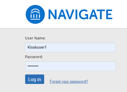

In the JavaScript file (signinjavascript.txt):
document.getElementById('login').value='john';
document.getElementById('password').value='letmein';
document.getElementsByName('commit')[0].click();
The filter file has PWB analyze each URL, specifically for one that starts with "https://seminolestate.campus.eab.com/session/new", and when it matches inject the JavaScript from the "signinjavascript.txt" file.
This will fill in the "login" element with "john" and the "password" element with "letmein" and then click the "commit" element.
Notice we had to use the get element by name in the second command as the "commit" element does not have an ID.
